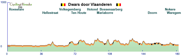

team fl wrote: ↑Mon Mar 30, 2026 10:44 amRoute 2026 is different from Route 2025:
- Total Climbs: Increased to 12 (compared to 10-11 in previous editions).
- New Climbs: Added Hellestraat (km 48) and Onderbossenaarstraat (km 107, 1.4km long, 10% max).
- Earlier Climbing: The hill zone begins 21km earlier than in 2025, with climbing starting after 47.7km (-> Hellestraat).
- Structure: The race retains the familiar Flemish Ardennes key spots, including double ascents of Berg Ten Houte, Côte de Trieu, and Hotond, with 7 cobblestone sections.
- Finish: The finale remains in Waregem after a double loop via the Nokereberg and Herlegemstraat.
- Length: approximately 185km
Source: Cyclingstage.com and official homepage as well as La FlammeRouge.
GPX-File: https://cdn.cyclingstage.com/images/dwa ... /route.gpx
With
Hellestraat +4 +4
Onderbossenaarstraat / Bossenaarberg +7 +3
Taking comments until early tomorrow morning, when I am going to publish it.
With
Hellestraat +4 +4
