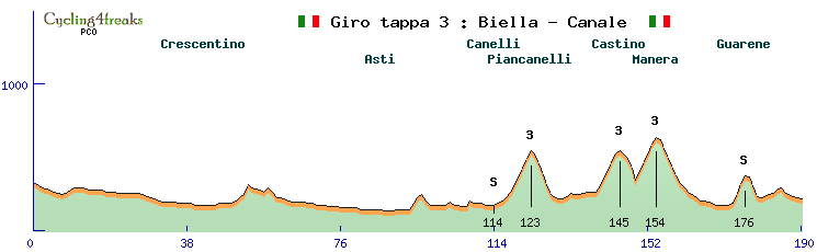

- For stage 3 seems LFR profile missing 3 km, and Giro website theyy announced 193km, LFR only 190

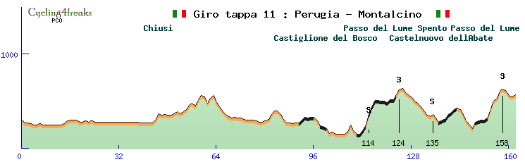

- stage 11 white road longer is a sector and harder * are, but I never go higher than ***. I tried to made it like */*/*/*/**/**/**/**/***/***/***/*** for example for the longest sector

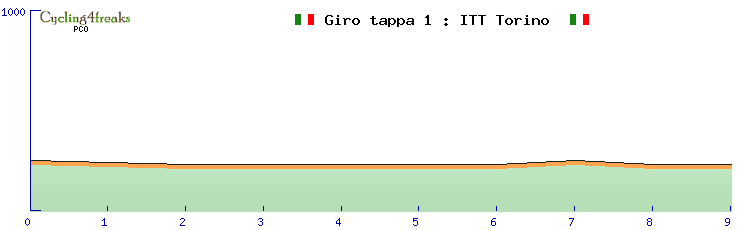

Stage 1: Looks perfect.

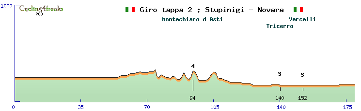

Stage 2: Looks perfect.
Stage 3:
- 190km is correct. Maybe they updated on Giro Website? Always makes sense to check later in April, by the way. RCS Sport likes to change the route in last minute...
- Castino and Manera both only category 4 climbs (not 3)
- According to LFR there is one small climb named "Occhetti" (0.5km @6.3%) at km 185. Maybe it can be a +3 here? Or even +4?

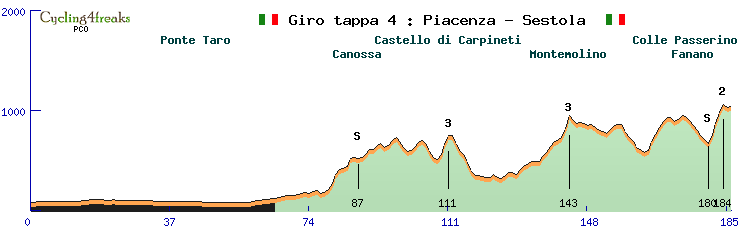

Stage 4:
- KOM of Colle Passerino is km 183.5 and finish at km 186.0, so 2.5km flat... Difficult to say on the map where exactly the finish line will be in Sestola... with 2.5km could be a reason to round upward to have 3km flat somehow instead of 2km... but 2km O.K. too. Except anybody knows for sure where they put the finish line :D

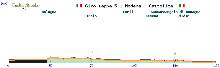

Stage 5: Looks perfect.

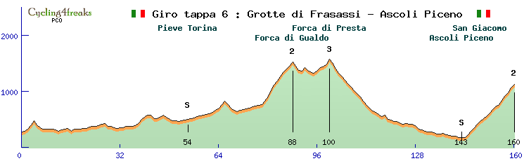

Stage 6: Looks perfect.

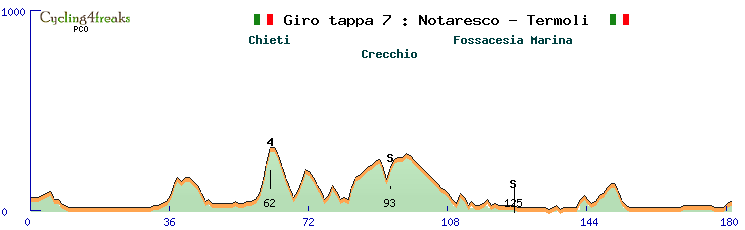

Stage 7:
- Last two kilometers you put +2 +1. LFR says there is 0.4km @4.3% at the end. On the map, looks to me like they are coming from the beach road (so altitude +0m basically), sharp turn right into a narrow road with city pavé (Street View) at km 179.6, then the +4.3% for 0.4km, they are at +27m, then a grind to +37m on the finish at m 181.1km. So as I think in real life that can be an opportunity for an attack or make a very chaotic sprint... I would maybe put +3* +1.

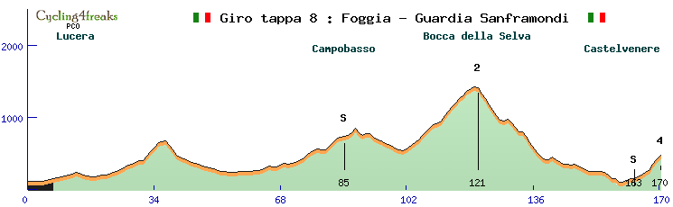

Stage 8:
- Finish may be +7 +7 +6 according to LFR (instead of +7 +7 +7)? But again just very small detail. Like above, you decide.

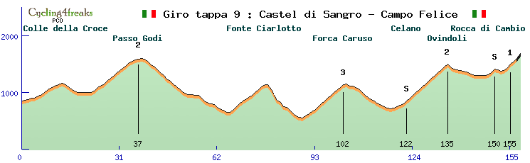

Stage 9:
- Oh damn, the gpm/cobble bug... big problem always... makes sense to solve it like you solved it.
- Finish is +5 +10* ? Here is the start of the gravel on Street View. Gravel sector is 1.3km. As in RSF +10* is basically the same as +10.... I would argue +5* +10**. Would still not make a huge difference probably... but should be less of a very clear climber win in RSF and real life. Flat/Pavé should count a little bit here. KOM then before the +5 even?

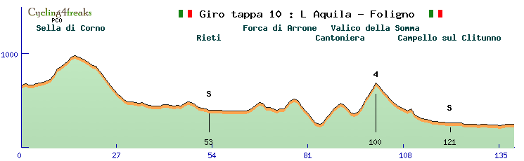

Stage 10:
- Mintact km100 maybe an error? I think before the climb (km95) or much later (km120) makese more sense?
Stage 11:
- This stage is going to be FANTASTIC (so I looked a bit into the details)
- I like how you did the white road. Probably more realistic than Strade Bianche (I have it on my To-Do List for 2022.)
- Mintact km162 is an error I think? :D
- In addition, I tried to look at each sector for specific difficulties. Remember how on Strade Bianche there are sometimes small, difficult sectors or small steep climbs. If there is something difficult, can increase the *... but yes, more than *** would be unrealistic for sure.
- On sector 2, I looked at the climb to Castiglione del Bosco (km112-115). The switchbacks look really tough on Street View, so perhaps can do ** instead of * on the climb, especially as you have to leave the gpm-km without * because of the gpm/cobble bug...
- On sector 2, the Passo del Lumo again doesn't really look like *** on Street View, more like **... but ok, again gpm/cobble bug so you have +5*** +5 (GPM).... I think I'd be for +5** +5** +2 (GPM)... as you did on stage 9, you can move the GPM here as well.
- On sector 3, LFR has 1.0km @+6.4% in the middle of the sector. You have "only" +4*, looking at Street View, I think it is indeed more like +5** or even +6** at this km.
- On sector 4, LFR has 1.2km @+6.7% at the beginning of the sector. You have a +7 there, but BEFORE the sector. I think it is ON the sector. There is no street view for this, but a Google Picture and you can see the white road. So I think it should be +7* at the start of the sector.

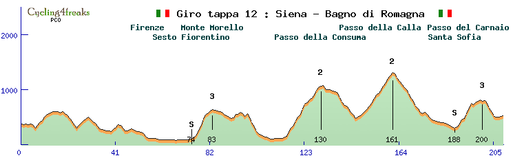

Stage 12:
- Mintact km149... looks early, but OK for me.

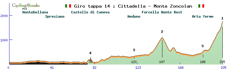

- Somebody can check the Zoncolan percentages, or wait until Giro has them officially on website.

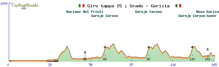

Stage 15: Looks perfect.

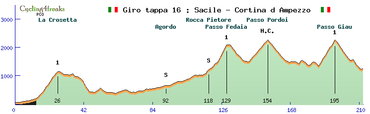

Stage 16:
- Mintact km187, is that on the Giau? Perhaps a few km earlier better?

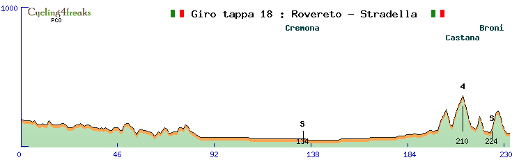

Stage 18:
- Cicognola according to LFR 1.4km @7.5%. You have +2 +7. Canneto Pavese according to LFR 2.6km @5.7%. You have +3 +6 +6. Both OK, but maybe worth checking Giro website later again, as I have no idea on the details.

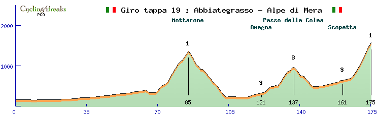

- 1km missing vs. Giro page (175 vs. 176)... no big problem.

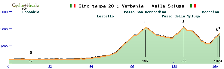

Stage 20:
- 1km missing vs. Giro page (164 vs. 165)... no big problem.

- stage 8 final now is 3/8/7/6
- stage 9 final 1/5/7/5/4/9* + modification on Ovindoli too
- stage 10 mintact change km 96 now
- stage 11. Mintact is km 91 sorry ! I redraw Casteglione del Bosco - Passo del Lume Spento.
About *** a part of me is agree with Donkey, and another think that some climbers hae some cobbles skill for that. For the moment I switch all white road on **

- stage 12 redraw and mintact km 190

- stage 16 redraw
